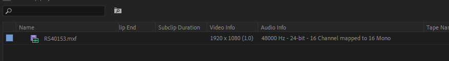

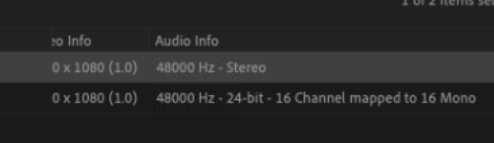

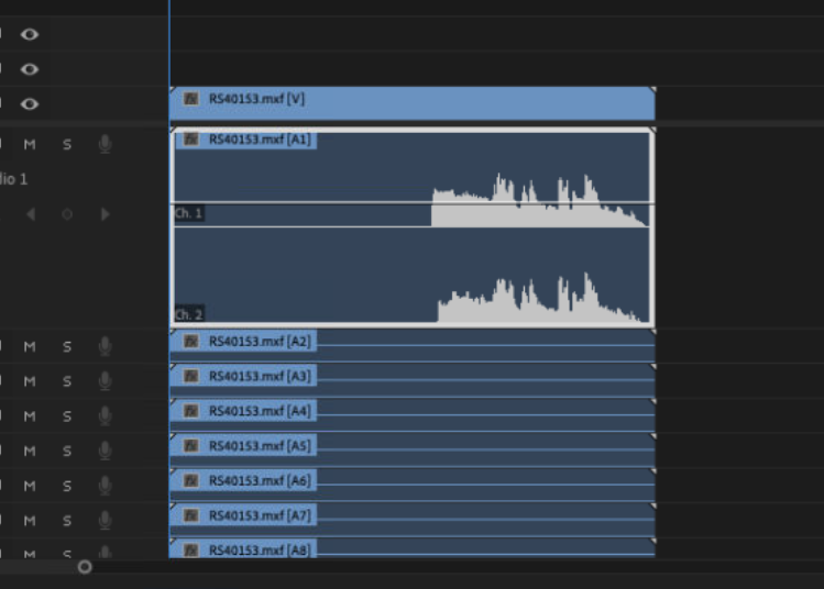

I'm trying to figure out how to re-map an MXF with 16 mono tracks to 8 stereo.
I've attached screengrabs of how the 16 mono looks in Premiere and how it looks after manually re-mapping to 8 stereo in Premiere.
I'd like to create a watch folder that does this outside of Premiere.

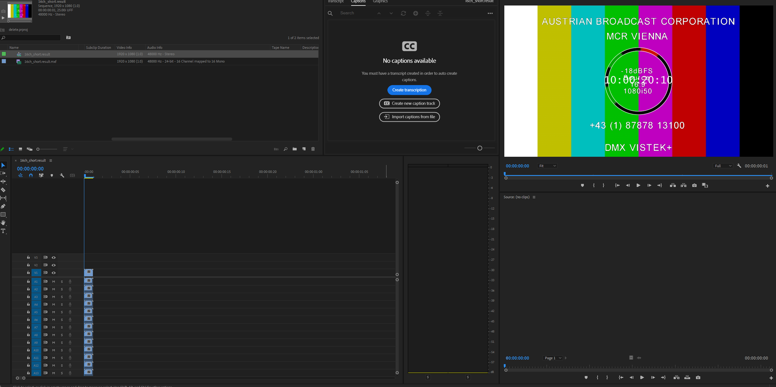

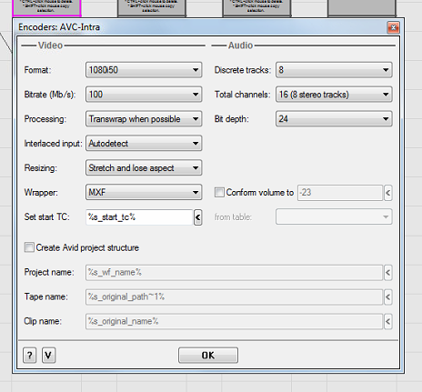

I've tried setting the encoder to 8 16-8 Stereo with no luck.
- Encoder Setting

- 16 Mono In Premiere
- 2.png (118.03 KiB) Viewed 10909 times
- 16 Mono - Re-Mapped To 8 Stereo
- 3.png (106.11 KiB) Viewed 10909 times

just tried it out: created a 16mono tracks file using the inbuilt xavc encoder, then reset the same job to create 8stereo, discrete tracks 8, total channels 16 setting. Cannot reproduce a problem here. What you mean with "no luck"?

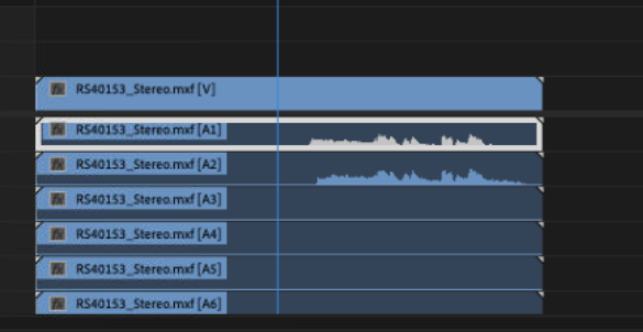

With the encoder set to Discrete Channels 8 - Total Channels 16 (8 Stereo) - The inputted 16 Mono MXF exports the same as 16 Mono.

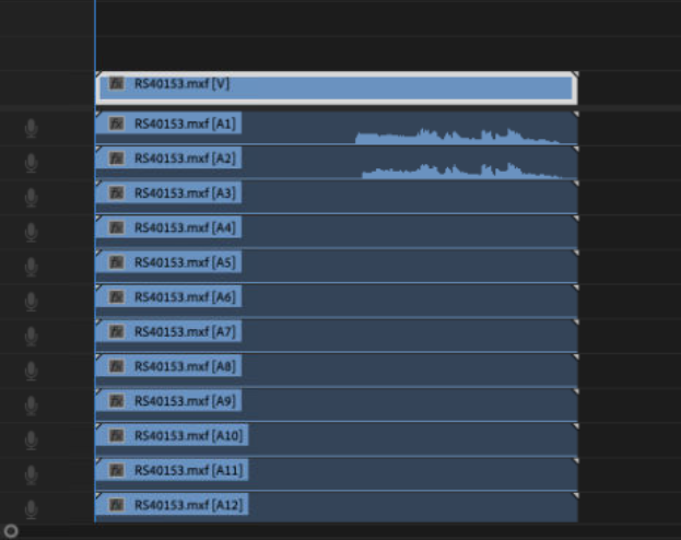

See attached how the exported file looks in Premiere.
- Tracks 1+2 are on separate tracks. Stereo tracks in Premiere sit on one track.
- 6.png (70.96 KiB) Viewed 10874 times
- Premiere States The File Is Still Mono.
- 4.png (14.65 KiB) Viewed 10874 times

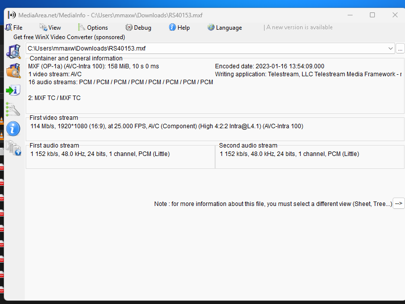

Here the workflow i used for creating 8 stereo: Here a source file i created with 16 mono tracks: If i submit this source file to the workflow, according to mediainfo the output has 8 stereo tracks. Can you reproduce that?

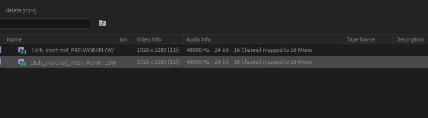

- How source file (pre-workflow) is shown in Premiere - 16 channel mapped to 16 mono
- 01.png (6.87 KiB) Viewed 10802 times
- Meda Info of source file.
- 02.png (70.05 KiB) Viewed 10802 times
- How file looks in Premiere after the workflow - marked with _StereoOutput.
- 03.png (10.99 KiB) Viewed 10802 times

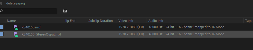

I've run your MXF through your workflow and Premiere is stating it is also 16-Channel mapped to 16 mono - so no change to being stereo as far as Premiere is concered. The only way I can get FFAstrans to output a stereo MXF is setting it to 1 Discrete Track / 2 (1 Stereo). Premiere see's this as a stereo file.
I've uploaded a test MXF I've made with Media Encoder.
AVC-Intra100 50i - 16 channels.
Running it through your worklfow results in the same audio track layout as it started with. 16 channel mapped to 16 mono in Premiere.

Interestingly this works when the encoder is set to ProRes. The outputted file imports to Premiere as 8-Stereo with track one playing back stereo as intended. I've used the same audio settings as with the MXF AVC Encoder.
Looks to be an issue with the AVC-Intra Encoder from the looks of it.

I'm running 1.3 on my local home PC and I'm seeing the same result of no change it audio layout in Premiere post the workflow.
Edit:

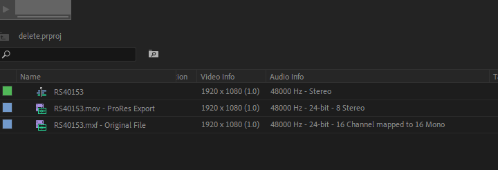

- Encoding to ProRes results in the expected stereo import.
- 06.png (12.72 KiB) Viewed 10776 times
- Encoding to MXF AVC-Intra results in no change to audio settings.
- 05.png (11.48 KiB) Viewed 10777 times

Your MXF attached imports to Premiere Pro as 16 channel mapped to 16 mono - This is the result I get with MXF files.
ProRes encoder works as I want it to by converting 16 mono to 8 stereo tracks - Premiere also recognises it as a stereo clip. (My 16 Mono MXF's are stereo - tracks 1+2 make the stereo and so on. I'm just trying to skip a step by not having to re-map within Premiere Pro to combine tracks 1+2 into one stereo track).
The reasoning is that Premiere AAF export splits all tracks into discrete mono tracks. Meaning that a stereo track split between tracks one and two are split into 4 mono tracks on the AAF export and this slightly annoys our dubbing team.
I'm happy enough using the ProRes encoder to achieve my intended result.

- 16ch_short.result - Shown within Premiere Pro
- 07.png (332.82 KiB) Viewed 10742 times

Well it is one thing how Premiere and Co. transform the original file for internal use but i am very interested in why the files you shared and the mediainfo analysis all say it's mono tracks. You'd definitely face a bug if you set 8x2 layout in the encoder but it produces 16x1 instead.
I just tried with the most current download version 1.3.0.2 but still i can't get the workflow i shared above to output mono files.
Do you think there is a bug in ffastrans or was there just a confusion with how premiere presents the audio tracks in the virtual timeline?
