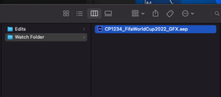

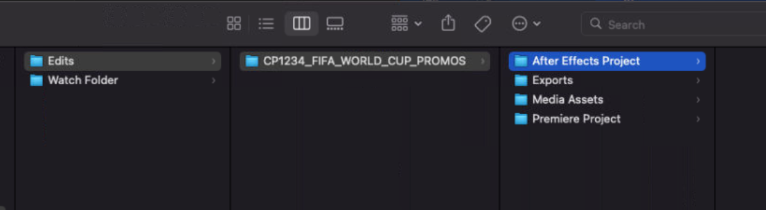

Yeah so the CP1234 folder is the first thing that is created before any After Effects/Premiere Projects are created. In almost all cases the Project folder will be there. Editors add this CP1234 tracking number to the start of project files and other exports. This makes it easy to search and find assets in the future.
However, the project folder title after the CP1234 may not match what the editor has called their project. I've attached a screen grab as an example. I'm hoping there could be a way that as long as there's a folder starting with the same CP number the file can be placed within here.
This watch folder could be used for any media assets a remote editor may upload. I'm just using an After Effects project as an example. It could be an MP4 that starts with CP1234 or a .mov ProRes file.
- Where file would be placed
- 09.png (87.16 KiB) Viewed 13398 times
- File in Watch Folder
- 08.png (65.41 KiB) Viewed 13398 times
