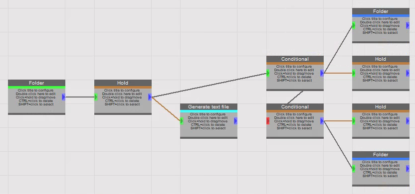

I have a workflow that is failing silently at a point with two conditionals.
These conditions just check resolution and sort to two folders.
The way Im thinking it should work (correct me if im wrong).
Is the sd-testFile.mp4 should fail the top conditional then succeed on the bottom one as the test file has "%i_height%" of 240
But it doesn't. Why?
The workflow is a recreation of a much larger workflow so the one attached is just used to recreate the issue.
Here is the sceencap of the issue.
Here are test files information:

very nice problem description, well done. Pretty sure you found a bug, what happens is that your jobs don't "finish" at all (because there is no full_log.json in the job log dir).
It occurs to me that the "reason" is that you make exhaustive use of a very little known and used feature, the "brown" connections. Not sure if you are aware what the "brown" connections are for but again, it's a little used feature and i'd advise you to only make use of it if you really need it.
I tested your wf and everything works without the brown connections, so the advise for workaround would be not to use brown connection type.
If you understand what the brown connection type is used for, you should also understand that these 2 workflows are doing literally the exact same thing, it is more or less just a different representation in the workflow editor. So it should not be a real problem for you to workaround the issue in production workflows.

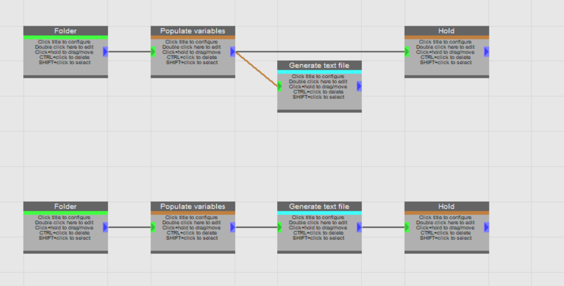

Basically the brown connection (let's say execute before" feature) does 2 things for you:
-) it saves you some workflow connections
-) s_source is preserved to the "current" value
One could say that it is a shortcut to make the workflow easier to build, but it does not deliver anything that you cannot do without brown connections.

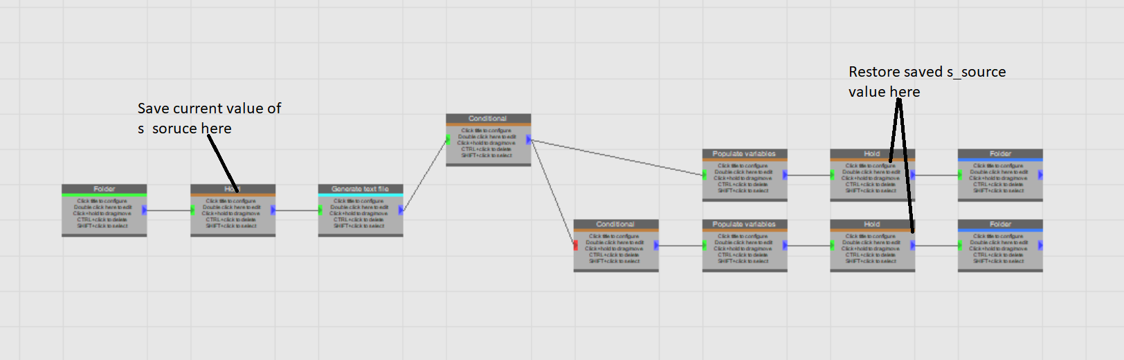

This image shows how your workflow would look like without brown connections e.g. the hold (which represents a whole bunch of nodes) is exectuded before the delivery. At any point in the workflow, you can just store the current value of s_source and when you are done with the stuff you did under the brown connection, you can just restore s_source.
Of course it is possible that there could be an easier workaround as soon as steinar investigated the issue but until then at least you got something to work with.
