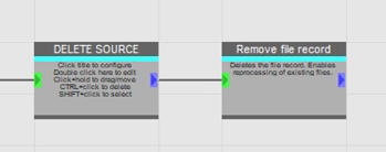

My workflows are now not processing files it has already processed. I have a delete source file node at the end of the workflow:
%comspec% /c "del /f /q "%s_original_full%""
I also have the below for remove file from record - which has always worked in terms of making the workflow forget about the file so it can in theory be process again should I place the file back into the watch folder:
%comspec% /c "del /f /q "%s_cache_record%""
I've moved FFAStrans to a new PC - wondering why this has stopped working?
Screenshot 2023-06-20 160936.png (24.99 KiB) Viewed 8852 times

So it looks like when I've upgraded the workflows from pre 1.0 (I had a very reliable Win7 PC that I've just recently replaced) - Some of the watch nodes have had 'Forget Files' unticked.
Do I need this remove Cache Record node with 'Forget Files' enabled?
Re: Remove Record/Forget Files Not Working Anymore
Hi Graham,
You're right; you can now remove your "remove file record" node, this is exactly the purpose of "forget missing files" , FFAStrans will synchronize the files history to the actual files. To sum up, be sure to remove your source file (otherwise there is a risk of a loop) and that's all, you will be able to process again the same file name.
