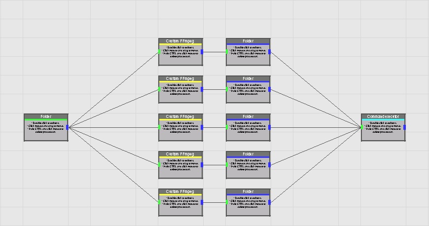

Re: Renaming Files
I have managed to delivered in one folder using batch command.
I have used mover command as per below.
@echo off
SET Today=%Date:~10,4%%Date:~4,2%%Date:~7,2%
mkdir D:\FFAStarns_Test\Outbox\MP4-%Today%
move D:\FFAStarns_Test\Outbox\4.5\*.* D:\FFAStarns_Test\Outbox\Mp4-%Today%
move D:\FFAStarns_Test\Outbox\3\*.* D:\FFAStarns_Test\Outbox\Mp4-%Today%
move D:\FFAStarns_Test\Outbox\2\*.* D:\FFAStarns_Test\Outbox\Mp4-%Today%
move D:\FFAStarns_Test\Outbox\1.3\*.* D:\FFAStarns_Test\Outbox\Mp4-%Today%
move D:\FFAStarns_Test\Outbox\800\*.* D:\FFAStarns_Test\Outbox\Mp4-%Today%
SET Today=
It's working perfectly for me.

Re: Renaming Files
That's neat, vijm1972
However, your workflow seem a bit over complicated.
Have you tried setting you folder destination to f.ex: D:\FFAStarns_Test\Outbox\MP4-%MM%%YY%. Please look at the variables on how you can dynamically create new date/time-based names.
And also set suffix to:
_4.5Mbps
_2.5Mbps
_1.5Mbps
_800Kbps
_650Kbps
...on you 5 different folder destination. Unless I have misinterpreted your aim for the workflow I think this would be enough without adding the "Command Executor" at the end.
Either way, it's great that you found a good way of solving it that works for you:-)

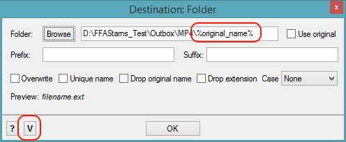

Is it the original name as picked up by your "Folder"-monitor you want to create? In that's case you need to look at the variables section for available variables.
Re: Renaming Files

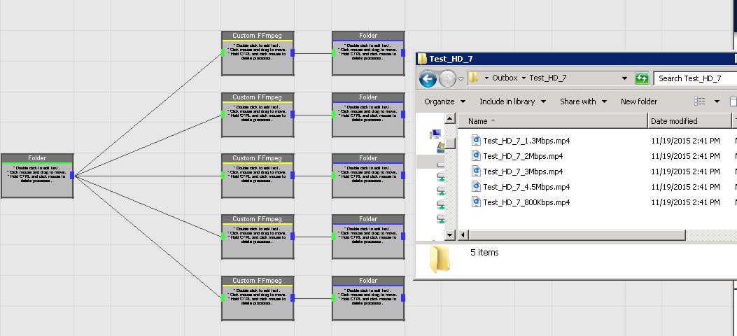

Thanks for your help.
Without using any batch file now I can move to the folder with source file name using variables "%original_name%".
Source File name Test_1.mxf
Output Folder Name Test_1
Under that folder all 5 versions using suffix.
I have created workflow as per attached img.
- MP4 Workflow with Folder.jpg (122.34 KiB) Viewed 15736 times
