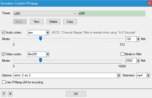

The current version has no built in h265 encoder but you can create your own custom ffmpeg preset using the "Custom FFmpeg"-encoder. It should be a trivial task if you know ffmpeg. If not, just search the net for a proper command line.
This should however get you gonig:
As for direct Hightail delivery; I have no plans to support that at the moment but if there is a command driven tool out there that does the job, one should be able to trigger it from the "Command executor"-node.
