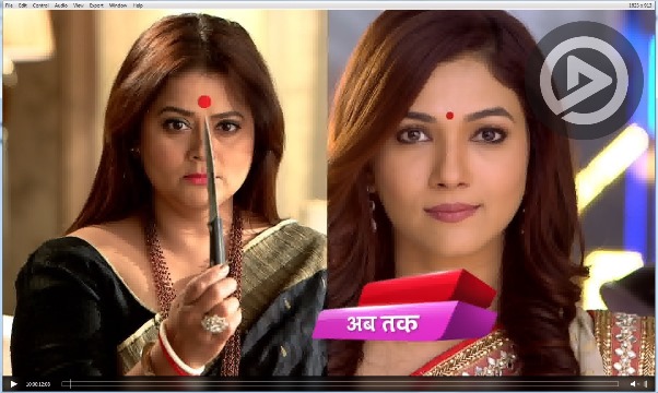

I am trying to transcode XDCAM-HD 422 using custom FFmpeg encoder, after conversion getting output as per attached screen shot at every 12 frames. When I processed same file through XDCAM-HD 422 encoder it's process perfectly.
1) Custom FFmpeg Output
You can see pixlation.

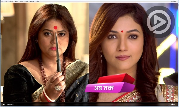

2) Encoder_XDCAMHD
Clean picture.
