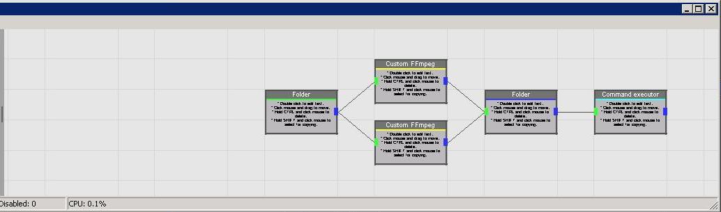

I have created workflow as per below.
1) Monitor folder
2) Custom FFMPEG MP4 and WMV
3) Output Location
4) Source move using Command Executor
Workflow processing correctly, I am getting MP4 and WMV in output location. But while moving source file it's showing me error. FFAstrans try to move source file two times. Please find attached screen shot of my workflow, can you please suggest if I am doing anything wrong?
Can you please suggest. I am using latest version 0.7.6 from shared location, when I run FFAStrans from local it's work perfectly on 0.7.5
Thanks,
Vijay

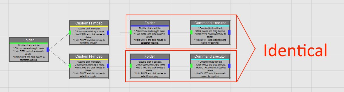

Hi Vijay,
I don't think there is anything wrong with you workflow. FFAStrans actually performs the operation like this:
Once you branch your workflow, you "create" unique instances of subsequent nodes but with identical settings. That's why the "move" opertation is carried out twice. Also, I take it that when you write "source" you actually mean the original file? If so, only one instance can complete the task succesfully. Either the original has already been moved, or it may be locked by the other encoder. Version 0.7.5 will report both as success but 0.7.6 will try to pick up the error state set by the executed command, which provides more correct feedback for the user. I take it that the file is moved just as expected?
