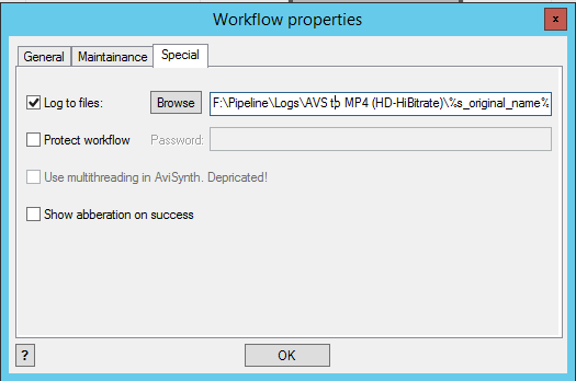

Unfortunately it's impossible to use templates in the directory name for log files:

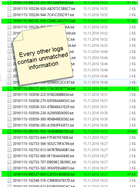

And there are a lot of orphans log files like this:
==> 2016-11-14 23:25:50.017 on Folder@RENDER-FFT-022, PID: 6636 -> Ticketfile is "F:\FFASTrans_stage2\Processors\.cache\tickets\x20161114-232549-532-43886F3C6554_20160609123554~glob~RENDER-FFT-022~20161114-214418-797-E40F98A3D259.ini"
==> 2016-11-14 23:25:50.017 on Folder@RENDER-FFT-022, PID: 6636 -> Getting top storage...
==> 2016-11-14 23:25:50.032 on Folder@RENDER-FFT-022, PID: 6636 -> Creating work dir: F:\FFASTrans_stage2\.work_media_cache\20160609123554\20161114-214418-797-E40F98A3D259
==> 2016-11-14 23:25:50.064 on Folder@RENDER-FFT-022, PID: 6636 -> Registering abort check...
==> 2016-11-14 23:25:50.079 on Folder@RENDER-FFT-022, PID: 6636 -> Executing ini: "mon_folder 20160504-201547-998-40DB3892D785"
==> 2016-11-14 23:25:50.079 on Folder@RENDER-FFT-022, PID: 6636 -> Executing sys: "mon_folder 20160504-201547-998-40DB3892D785"
It's not obvious, which log file belongs to which source video file. Usually I just filter it by size:

You can not use the variables like that on the log path. You need to construct the file path like this:
F:\Pipeline\Logs\AVS to MP4 (HD-HiBitrate)\%s_job_id%.txt
This string can be used in your workflow to localize the job log file.
