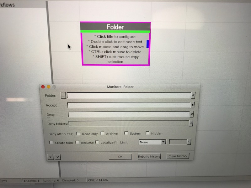

FFAStrans starts fine using Wine but can't be used to configure a processor.
When pressing the bar of a processor the processor details window keeps moving when moving the mouse. As a result I can never click on a field inside the popup to change the values. I can only press Esc to dismiss the popup window.
When using PlayonMac/Linux (v4.2) I could set some display parameters, but I don't know if these will have an impact:
- GLSL Support: *default*, enabled, disabled
- Direct Draw Renderer: *default*, gdi, opengl
- Video memory size: *default*, 32, ..., 4096
- Offscreen rendering mode: *default*, fbo, backbuffer, pbuffer
- Render target mode lock: *default*, disabled, readdraw, readtex
- Multisampling: *default*, enabled, disabled
- Strict Draw Ordering: *default*, enabled, disabled
I can also set:
- Mouse warp override: *default*, enable, disable, force
I tried the variations for this one and did not seem to have effect.
Under Windows the popup seems to be drawn in a somewhat non-standard way.
Any suggestions if there's something that can be done there?

Re: Ffastrans on Linux ?
I'm not sure how to approach this issue... FFAStrans is a Windows program and it utilize normal system calls for creating the GUI. Maybe I'm using it wrong but because it works in Windows It can't be THAT wrong. I would just advise you to try different settings in your emulator and see if they have any effect.
