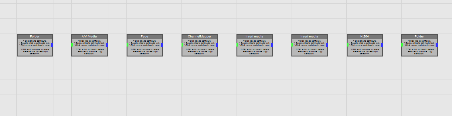

I need to create a new video with an intro video and an out video. The big issue is I need a transition effect between the main video and the out video (fadeout-fadein with an overlap during the transition process (20 frames)). I placed a fade filter in the workflow but the fade in of the insert media only starts after the fade out of main video finishes. Any tip to solve this issue?

Ah, I should have thought of that before. It should be easy to implement so will will try and do that for the next version. You can of course create a custom script but that means you need to be familiar with AviSynth.
