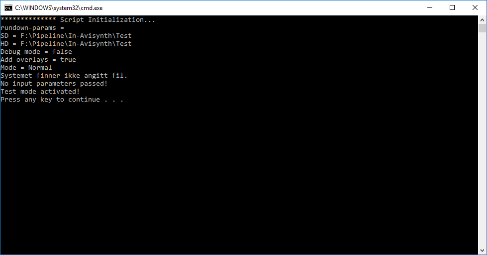

Alexander Sorkin
Re: FFASTrans 0.9.0.1 Command Executor bug
Are you running FFAStrans as service? In that case, the console output will not work. It must be run as application. When doing that, I cannot recreate the error in 0.9.0.1. The console shows up nicley:
And as stated earlier, the code for running commands has not changed from 0.9.0 to 0.9.0.1.
