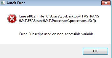

i try the new "image sequence" monitor in vesion 0.9.4+patch with DPX, and it works great when i encode the video directly, but i have an error when adding an A/V decoder and filters :
Thanx again for this great function !
Capture d’écran 2019-02-05 à 14.30.16.png (17.58 KiB) Viewed 10277 times
Re: DPX Sequences and vimeo upload
The sequence monitor was enabled by mistake on this release. It is not finished so that's probably the reason you see the error. But thanks for report anyway. I will take a look at it. Now that the monitor is out you should look at it as early beta.
