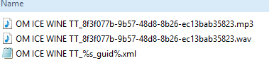

I've tried a few different ways of doing this, particularly by generating a GUID, storing it to a user variable, and trying to use that variable for both files via either two watch folders with the second watch folder filtered to accept only .XML files with the source file name without extension of the first .WAV file, or conditional statements "if .XML then" and "if .wav then" and then generating the variable after if WAV file and referencing that to both the "if XML" and the output folder blocks. However both methods result in the XML file with a file name that is literally "Filename_1_%s_guid%.xml". As in it's not putting in the stored variable, just the literal variable itself.
Here is the results of the output folder:

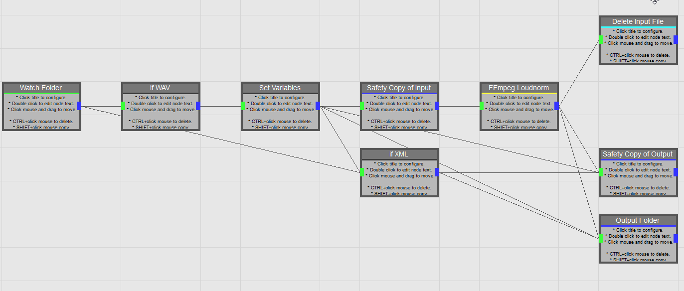

Here's a pic of how I tried (but failed) to apply the variable. I originally applied the set variable output just to two places, but started hitting multiple places as it kept not working.
I seem to be missing how to get the variable to be applied properly.

I simplified the workflow but still seeing the same issue.
Not sure how to pass a variable onto a different branch of the tree.
Workflow attached.
Workflow attached.

Re: Same GUID to 2 different files types with same filename
OK, i got it.
Unfortunately currently (and most likely in future) you need to see each branch of the tree as a completely separate job, branches do not share any variables besides the ones from their common main branch. So you need to set your guid variable on the main branch, before you break up into branches.
If it was different, how could it work to set %s_original_ext% to xml in one and to wav in the other branch...
Typically as a developer, i recommend to set your static variables as first thing in your program(/worfklow) anyway... So in my head, you insert one populate vars after your watchfolder and after that you break into branches. This first populate variables sets variables for all the stuff you use later, e.g. guid, output directories etc... This way you have all the stuff a user can change at one point.
I guess you understood, but just to be sure, here an example: cheers,
Well, you want to wait for wav and xml in the first branch. So just reconfigure your watchfolder to "*.wav" ONLY and wait until the *.xml exists by using a "Operations->Hold" node and wait for the other file to exist...
