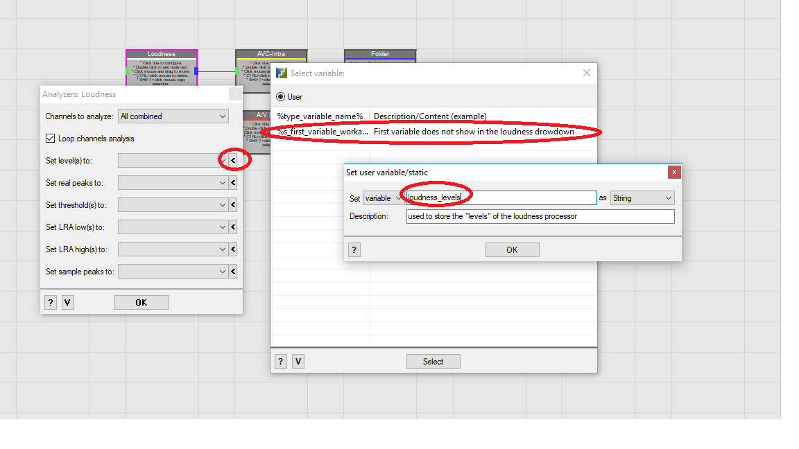

Re: LOUDNESS VOLUME CONTROL
1. click any of the fat < symbols in the loudness processor
2. in the "Select Variable" Window, rightclick and hit-> new
3. in the "Set user variable/static window, enter a name for the variable you want to create. On the right side, make sure the type is "String"
4. hit ok and close the Select variable window
5. in the loudness processor dropdown you can now select your created variable
6. if you want to apply loudness correction later on in an encoder processor, open the encoding processor, check the "conform volume to" box and select the variable from above in the dropdown.
@steinar, you are right about the "first variable" bug don't apply here, i got confused by the dropdown showing string only variables... sorry for that ;-)
