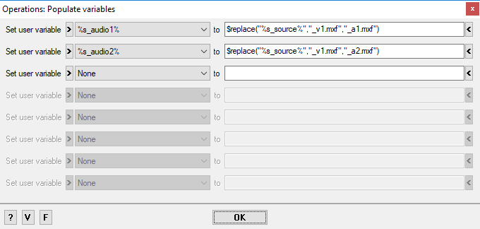

also for 2) if you have audios and videos in the same folder and videos are named ..._v1.mxf and audios ..._a1.mxf and ..._a2.mxf you could do something like that:
Your workflow always starts with a video file as source file. From there, you use a populate variables processor to calculate your audio filenames. E.g. if you have always 2 audios:
When you know the audio filenames, you can use a commandline processor and bmxtranswrap to wrap into op1a:
Commandline Processor:
Above command actually works, it will craete an op1a file wherever your input video file resides named _op1a.mxf
Basically i don't see a problem wrapping OPAtom to OP1a.
But what i see is that you describe 2 different problems:
1) how to distinguish between highres and lowres files
2) how to find the matching audios to the highres video files
for 1) Benjamin already asked for more input. Is there maybe something in the filename that we can use to distinguish Lowres from Highres?
for 2) how does your highres video file name map to the corresponding audios (or are the audios in separate folders)
cmd /C ""%s_ffastrans_dir%\Processors\mxf_tools\bmxtranswrap.exe" -t op1a -o "%s_source%_op1a.mxf" "%s_source%" "%s_audio1%" "%s_audio1%""emcodem, wrapping since 2009 you got the rhyme?

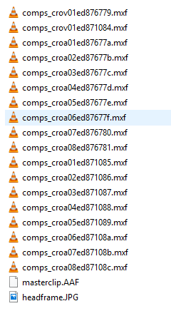

Hi guys,
I'm still having trouble renaming/passing through the files. Would anyone be able to help where to start? The only constant in the file names is that before V01 and A01, A02 etc. I have 9 characters. The screenshot below is the original file structure, however I managed to have just one resolution instance in a folder which I want. How can I pass the files to transwrapping node?
Thanks again,
Igor
Thanks again,
Igor
- folder_structure.PNG (12.91 KiB) Viewed 19529 times

Re: Deciding and rewrapping workflow
... Also take in consideration using ffprobe for deciding which resolution to use.
Hey!
my first thought would be using regex as well but looking at the picture it does not seem like you can easily use the video filename to find the corresponding audios.
Is there one .aaf file per clip you want to rewrap or is the aaf file describing some more complex timeline or so? We can possibly go with the aaf as source file.
Could you share 2 small complete examples, audio and video? ...it can be like 10 frames long, just needs to be a valid clip.
cheers,
cheers,
