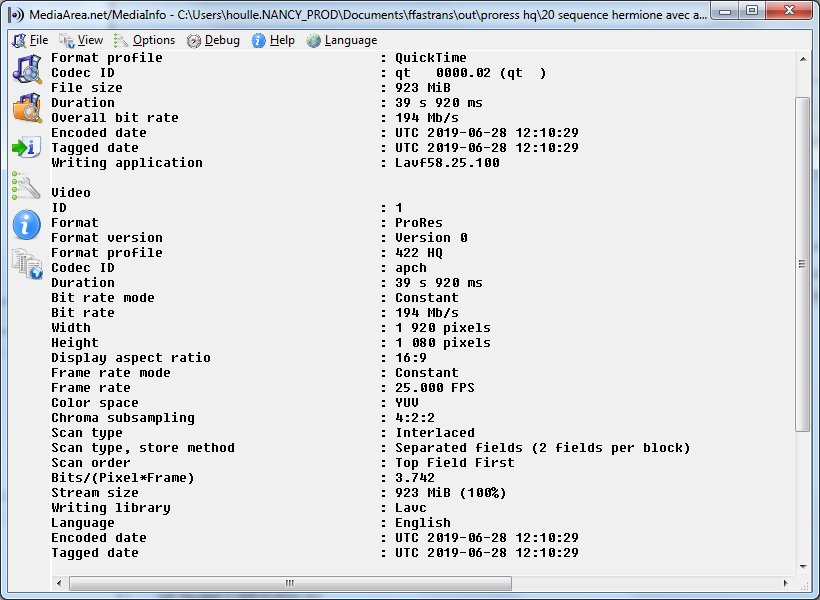

Hi emcodem. Thanks for your reply.
It works well with your indications. Options went : -profile:v 3 -flags +ildct+ilme -top 1 -pix_fmt yuv422p10le
Thank you!
