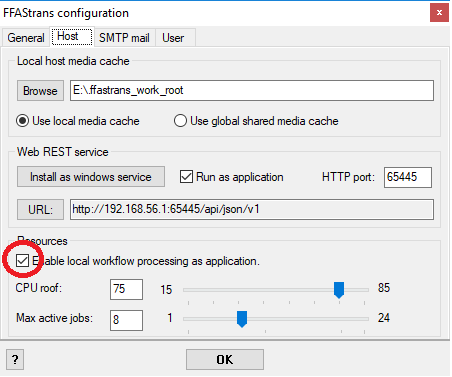

Did you install to run ffastrans as a "windows service"?

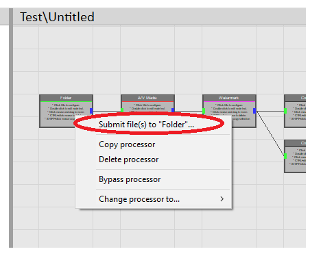

Please check Menu options->configuration:
And also please check what happens when you submit a file manually to the workflow.

I don’t know what happened, but when I advised you to send the file to work manually, after that the workflow worked automatically. And such metamorphoses with FFA often occur. Everything is set up correctly, but the workflow does not start until something happens in his “brain”. FFAStrans is very strange, but a good transcoder!))) Thanks for the help and torment!!
FOR HELP ... A checkmark in the checkbox stood.
