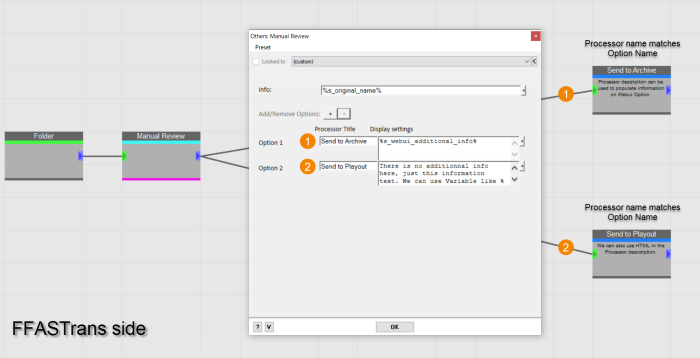

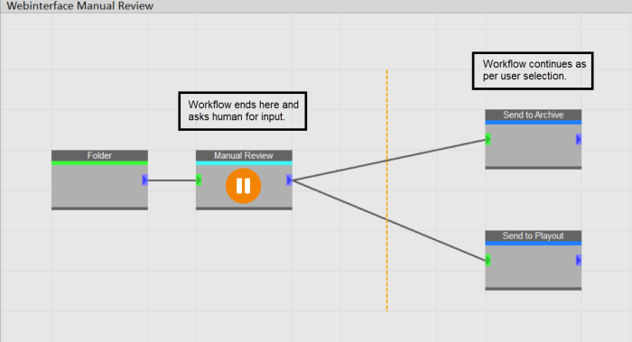

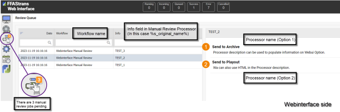

Since Version 1.4 there is Manual review (Review Queue) Menu Item. The intention is to “stop” the FFAStrans Workflow at a certain point and ask a human how to go on.
It can bring up a sophisticated html form for userinput for Jobs that are sent into waiting state (if there is any workflow using the feature).
We have 2 different features here, for many usecases using only the first one will suffice.
How it works:

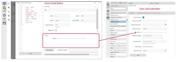

Regarding Job Submission from Webinterface, you can create a flexible Form for getting some userinputs.
Note that only variables that are actually used somewhere in the workflow are displayed as form fields on the webui. So after creating one webui variable, make sure to actually insert the created variable into some processor in the workflow (e.g. %s_webui_my_input%)
There is a GUI for creating and editing the look and feel of Form fields found on Webinterface in the “FFAStrans Admin”/Variables Section
The following types of userinput are supported:
Common Properties:
Calendar Date Format (https://docs.dhtmlx.com/suite/calendar/configuring/#date-format):
