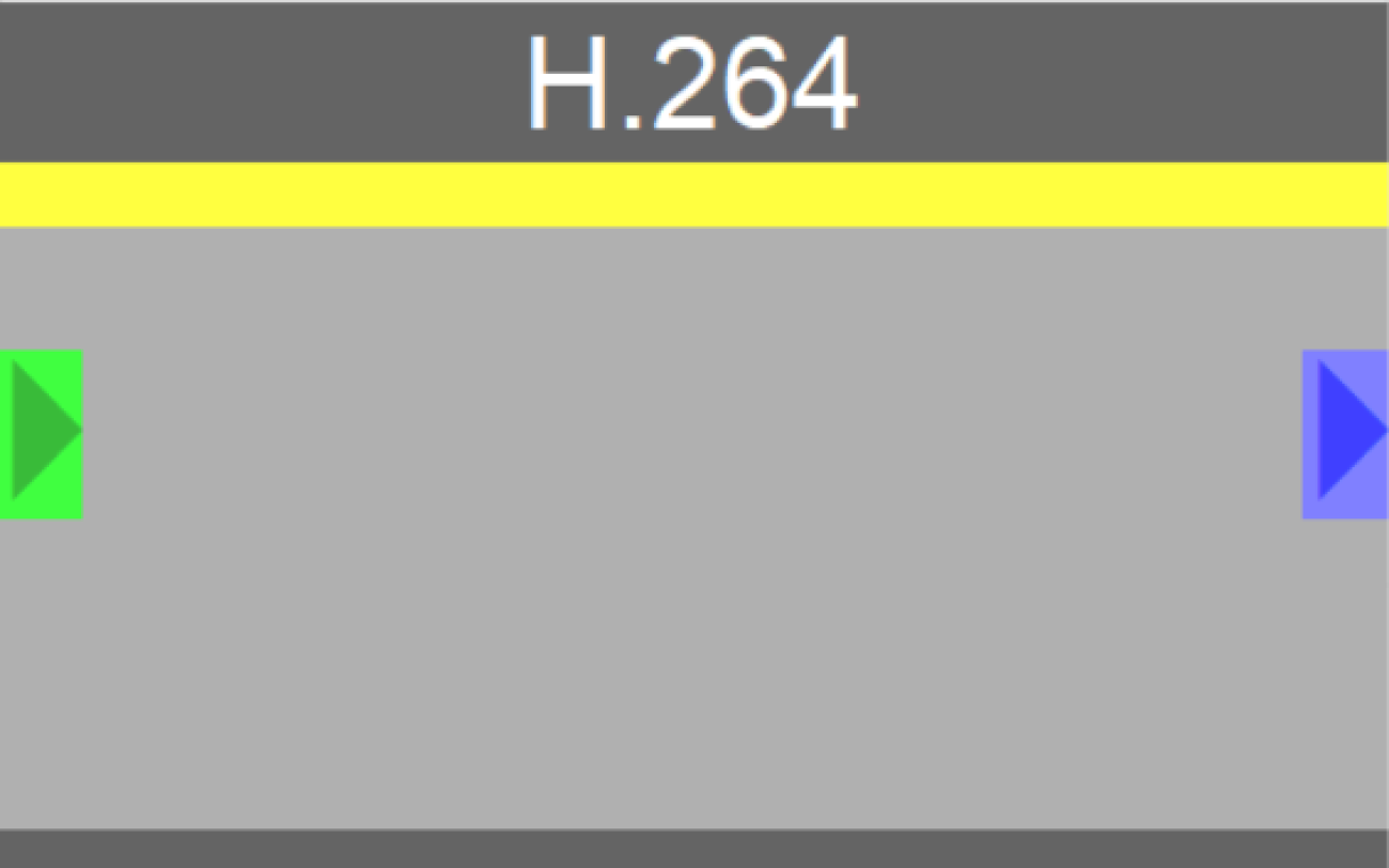

H264 encoder
Purpose
Encodes x264 video and AAC or PCM audio (MP4, M4V, MOV, MKV or MXF).
AAC PCM 16 bit PCM 24 bit
MP4 OK / /
MOV OK OK OK
M4V OK / /
MKV OK OK OK
MXF / OK OK
