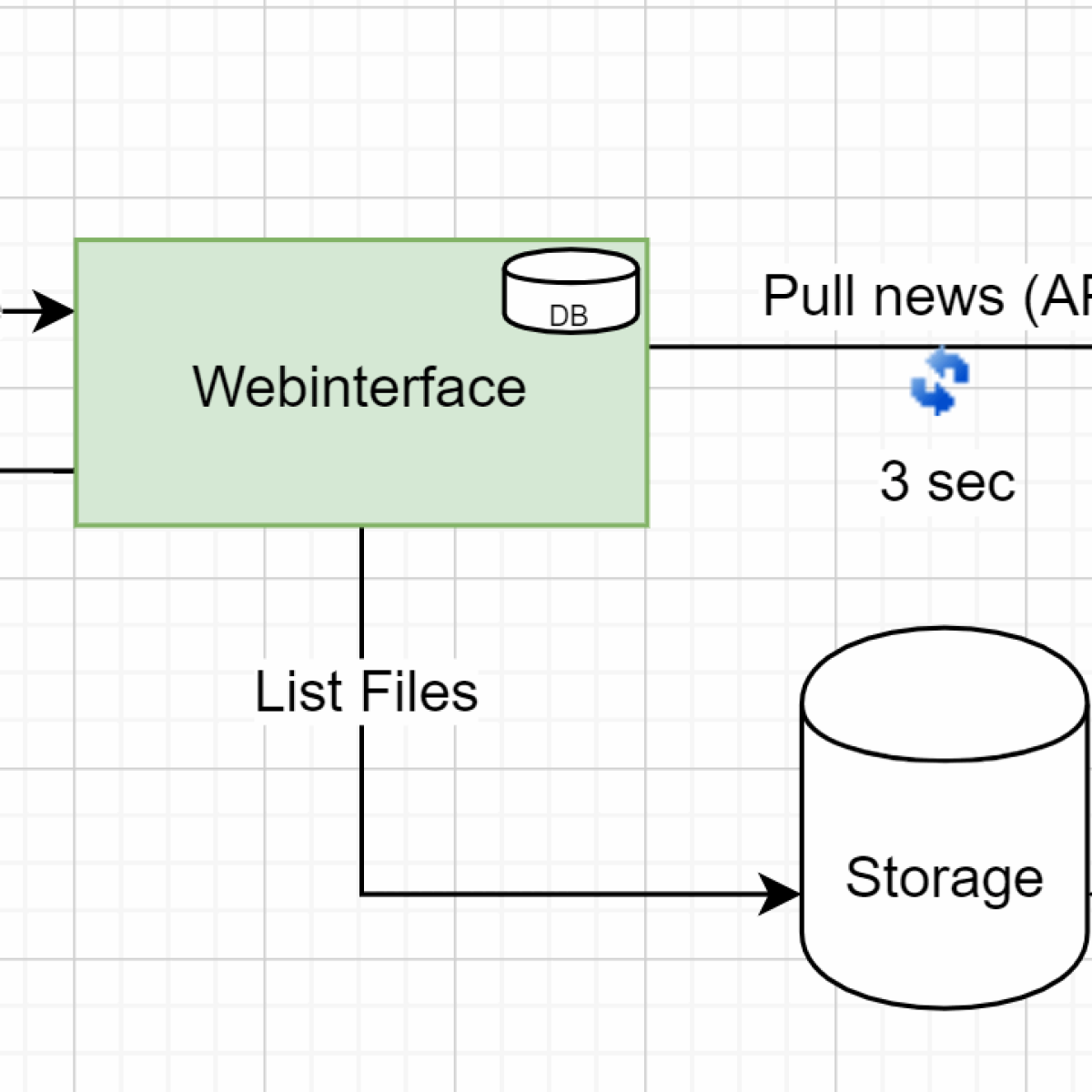

Architecture
The design allows to run the webinterface in a separate network from Users and FFAStrans perspective. In Simple environments of course, the webinterface runs on the same server as FFAStrans does.
The number of logged in users does not influence how often the Data from FFAStrans is requested so your production server is safe from a possible overload by too many users.

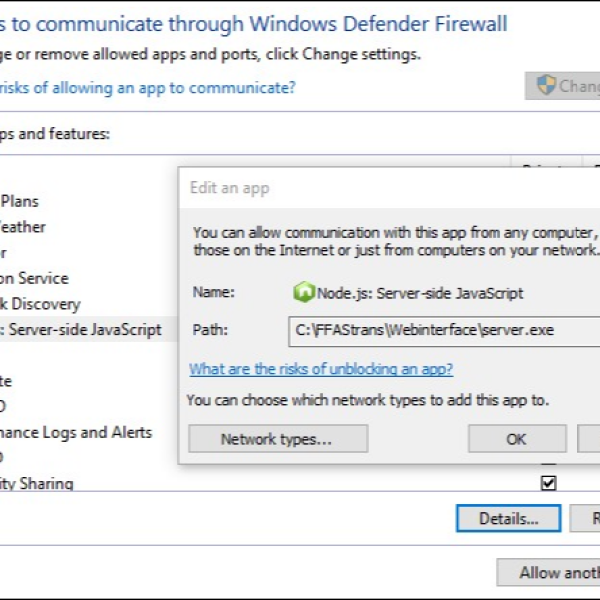

Note: : To access the WebInterface from another computer, don't forget to allow WebInterface app (Server.exe →Node.js:Server-side Javascript) to communicate through the firewall.

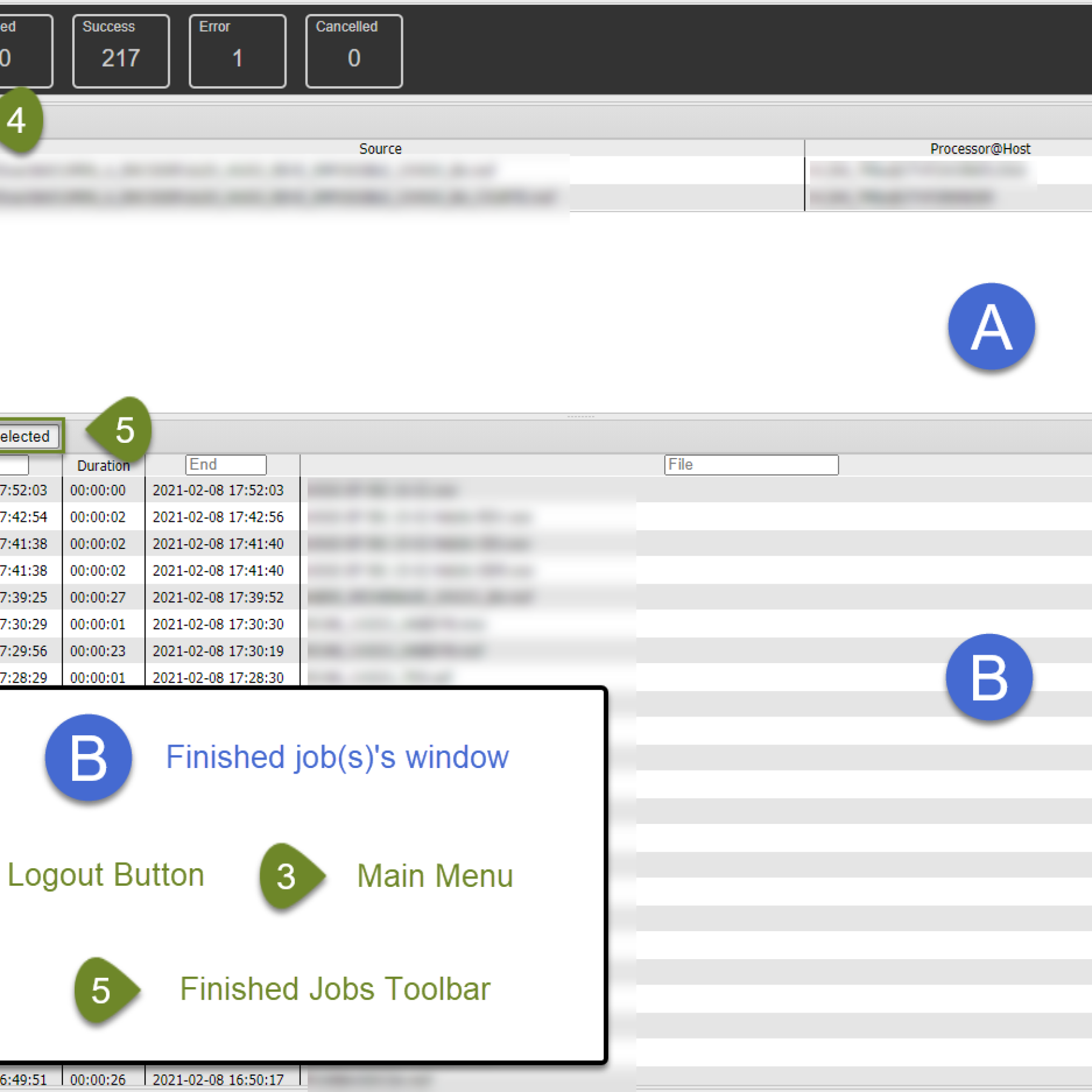

If your webserver(webinterface) runs on the same server as your main ffastrans server, open your web browser and type : http://localhost:3002
Details :
  • A: This is the job(s) running's window. You can see the job(s) in progress and the Estimated Time for Achievement(ETA).
  • B: Finished jobs window (Error/Success ). Note that the Webinterface stores jobs into it's own database and it will automatically maintain itself to keep 20.000 Records.
  • 1: Instance name in case you have multiple installations
  • 2: Logout Button allows to exit from the current session. Only works when you activated “STATIC_USE_WEB_AUTHENTIFICATION” in Server configuration.
  • 3: Navigation Menu. Use the User manager to restrict the Items a user can access.
  • 4: Running Job's Toolbar allows to interact on the current job. Abort, Pause or Resume a job.
  • 5: Interacts with finished job(s). You can delete all history jobs list or delete only selected jobs.

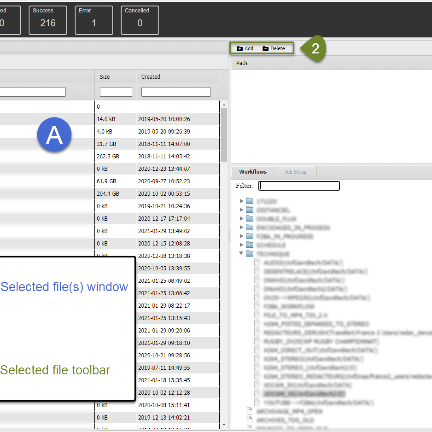

The Workflow Menu allows users to select files from existing Server locations or upload new files and start Jobs. Use the User Configuration Manager to Filter which Workflows and Variables users are allowed to utilize.
For the File upload, please note that this is only HTML5 file upload so it will be relatively slow and somewhat instable when it comes to Files bigger than some Gigabytes. Transferring huge files should be done using technologies that are intended for it (e.g. NFS, SMB, FTP etc…).
Details:
  • A: Browse window, make your file(s) selection here.
  • B: Here is(are) the selected file(s).
  • C: Choose your workflow in this window. Click on “Job Setup” to set the workflow selected(which monitor folder and which variables).
  • 1:
    • Locations: Select your different paths(Settings in Server Configuration).
    • Save Location: Save the current location into Locations selector
    • Add Selected: Add selected file(s)
    • Add all: Add all files in actual folder.
    • Info: Show path and file size.
  • 2:
    • Add: Enter full path to choose a file.
    • Delete: Remove file(s) selected.

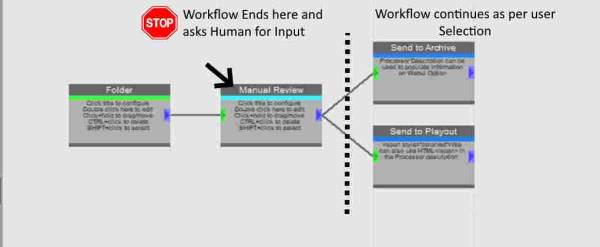

Since Version 1.4 there is Manual review (Review Queue) Menu Item. The intention is to “stop” the FFAStrans Workflow at a certain point and ask a human how to go on.
It can bring up a sophisticated html form for userinput for Jobs that are sent into waiting state (if there is any workflow using the feature).
We have 2 different features here, for many usecases using only the first one will suffice.
  1. Feature 1: Just connect 2 or more Follow up processors directly to the Manual Review output pin, the user can select only one of them
  2. Feature 2: Additionally create a Form using webui Form variables and get very sophisticated information from the user e.g. a MAM Metadata Form
How it works:
  • Insert the plugin processor “Manual Review” in your workflow at the spot where you want it to stop and ask user for input.
  • The webui user will see one option to choose from for each output processor you connect on output of Manual Review processor.
  • Optionally you can present a nice Form using webui form variables, after the user selected one option and before he starts the follow-up

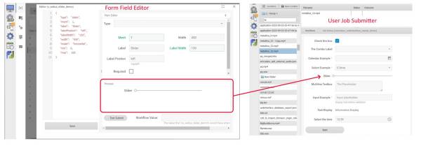

Regarding Job Submission from Webinterface, you can create a flexible Form for getting some userinputs.
Note that only variables that are actually used somewhere in the workflow are displayed as form fields on the webui. So after creating one webui variable, make sure to actually insert the created variable into some processor in the workflow (e.g. %s_webui_my_input%)
There is a GUI for creating and editing the look and feel of Form fields found on Webinterface in the “FFAStrans Admin”/Variables Section
The following types of userinput are supported:
Common Properties:
  • Merit: If your workflow uses multiple Form variables, Merit defines the Vertical Position of the Input Field.
  • Label: The label (text on the left) is not vey flexible, e.g. you cannot make colors. It supports top/left position and you can modify the label width. It is best to keep all label widths the same if your workflow has multiple inputs
