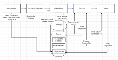

Workflow General information
This page should describe all “basic workflow information around workflows, e.g. branching behaviour etc…
File Flow
