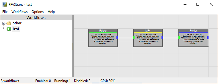

New to FFAStrans.
Watched the intro YouTube video.
Using Windows 10 and FFAStrans 0.7.7.
Steps:
- new workflow: "test"
- added processors:
. - monitor - folder: "...\in"
. - encoder - MP4
. - deliveries - folder: "...\out"
- saved workflow
- started workflow
- show status monitor
- pasted a H264 (or MXF) file from local filesystem into "in" folder
I tried a couple of other workflows (including decoder A/V Media), but in all cases I don't see anything happening.
Suggestions?

Re: nothing happens? basic workflow (folder-mp4-folder)
Hi wvku, thank you for using FFAStrans and welcome to the forum!
There should not be more to it than what you have already done. Can you please check and see if the "exe_manager.exe" process is running when you start the workflow?

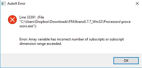

I have the exact same workflow set up and can't get it to execute. I checked the task manager and both processes are running. When I try to manually submit a file, I receive a line 33391 error. I tried running the same workflow on a different computer and received the same error. Anyone else experiencing this issue? I am very new to FFAStrans!

Hi enrightj, thank you for using FFAStrans and welcome to the forum!
I'm very sorry you're having problems with FFAStrans and I would be happy to help you out. Could you please export your workflow and send it? Also I would like for you to find out what program gives the 33391 error. FFAStrans has several sub-programs.

Attached is a screenshot of the error is receive. Below is my workflow:
Eh, sort of. The error tells me a lot but your workflow is empty. Are you sure you sent the right one?
Hi Steinar,
I likely didn't send you the right one. I'm guessing I should have sent you the contents of the ini file in the workflows folder. Here it is:

I have noticed that my workflow actually isn't saved when I exit and relaunch FFAStrands. Even after importing, my workflow view is blank. Could this be the culprit?
