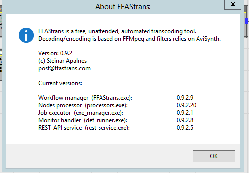

Can you please go to "Help"->"About FFAStrans" and give med the FFAStrans.exe file version?

Yes I understand that but I need to know the file version of the FFAStrans.exe file, not the main version, which is just 0.9.2. So it should read 0.9.2.8 or something like that.

Thanks for update...
It is 0.9.2.9..
Please find attached screen shot..
-Dinesh
It is 0.9.2.9..
-Dinesh
- FFAStrans.PNG (13.62 KiB) Viewed 14013 times
