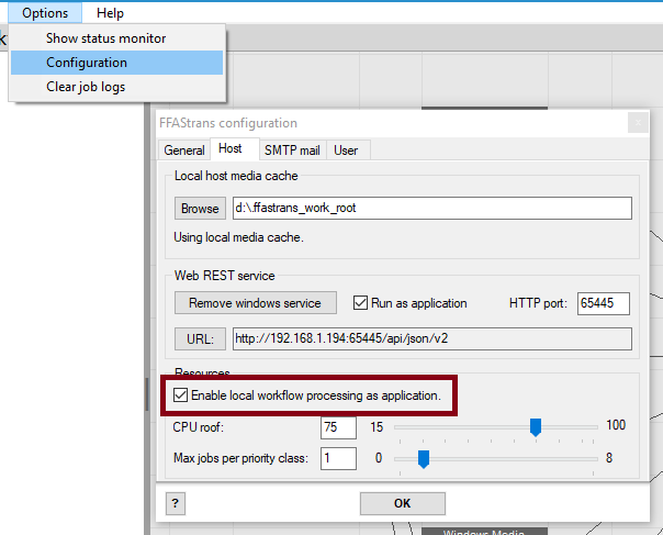

Re: Help Adding Intro Outro
Hi anshkid,
The error message you're seeing is a result of you trying to do something I would never have thought about: Restarting a job when you have no job on the list to restart. So, it's obviously a bug which is easy to fix so thanks for reporting. But basically, If you're not seeing anything in the monitor something is not working. So we need to fix that first. So just to make sure...you have started the workflow, right? I have seen people forgetting this so I just needed to ask. Also, make sure you have enable local processing in the main "Configuration->Hosts". It should be enabled by default when you start a fresh installation of FFAStrans.
