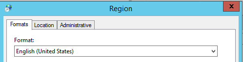

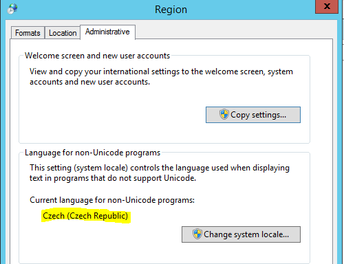

This is my actual setup:
- Region > Formats Tab: English (United States)
- Region > Administrative Tab > Language for non-Unicode programs: Czech (Czech Republic)
With these settings set up on all servers in farm I don't see double processing anymore.
Region - Formats - English.PNG (4.11 KiB) Viewed 15333 times
Region - Administrative - Language for non-Unicode programs - Czech.PNG (14.77 KiB) Viewed 15333 times
The root cause of the "double proccesing" was, that I had mistakenly set "Language for non-Unicode programs" to English instead of Czech on one of the servers in the farm.

Re: A file dropped to watchfolder processed by both transcode nodes in a farm
That's quite interesting, though...
I wonder what is Windows reading with that setting differently that makes it think it has to pickup the same ticket twice...
Anyway, nice finding and thanks for sharing.
