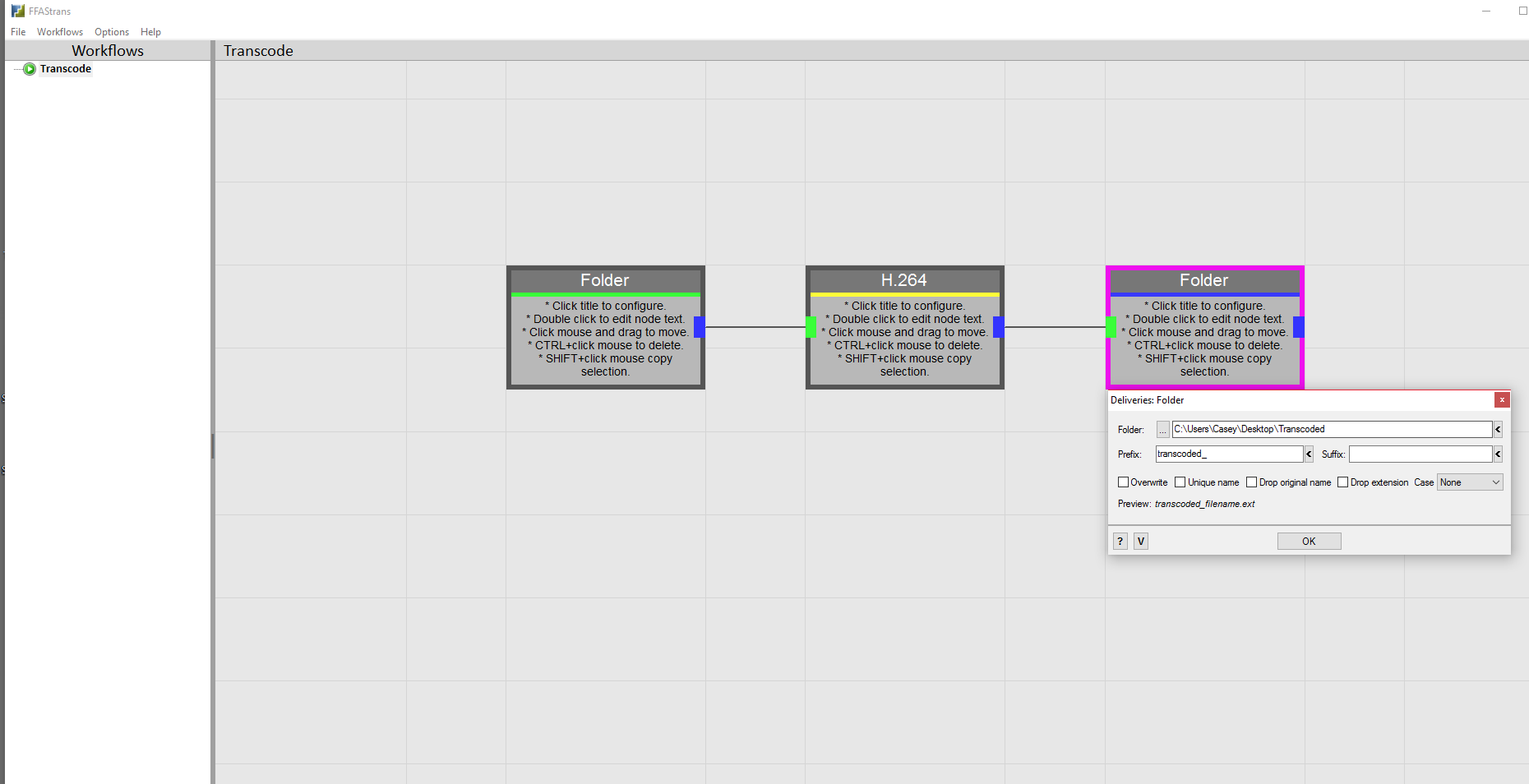

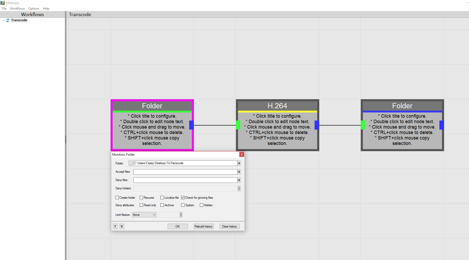

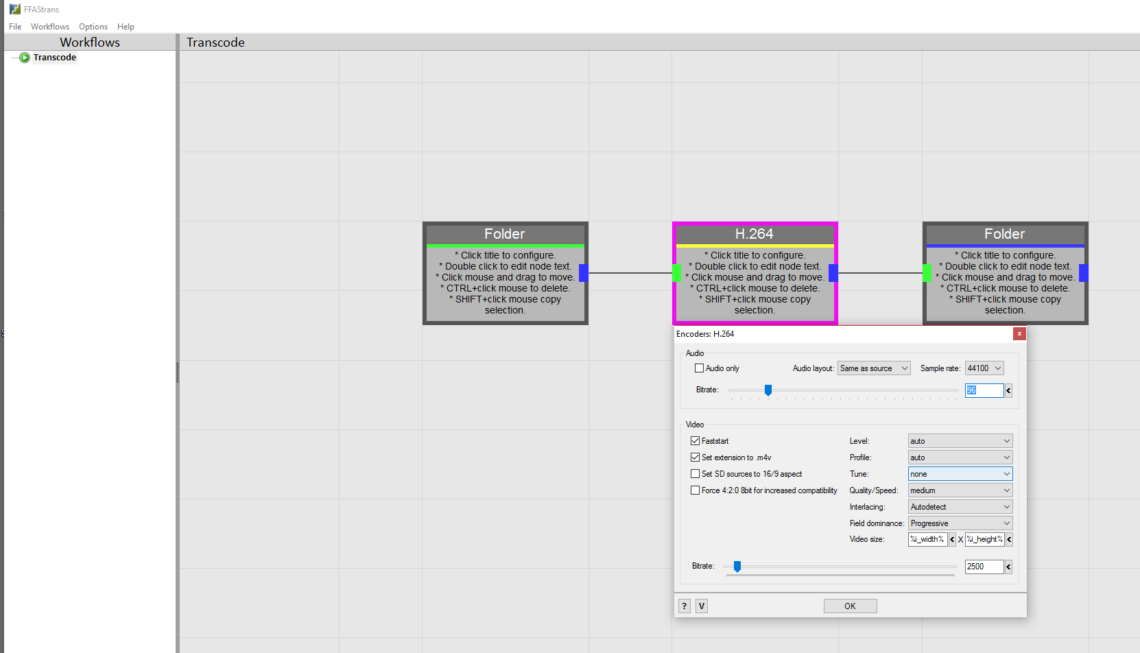

This is my first time trying FFAStrans, and cannot get monitor folders to work. Every time I put a file in the folder I designate, nothing happens. Can anyone tell me what I'm doing wrong?

Hi caseymazur,
You need to mark 'check for growing files' and define the input-filetypes (accept files), for example *.mov
If you want to transcode all kind of av-files which ffmpeg can process just use *.*
In addition you should define poll-intervall. Right-click your input-folder and choose the amount of seconds.
Taner
Taner

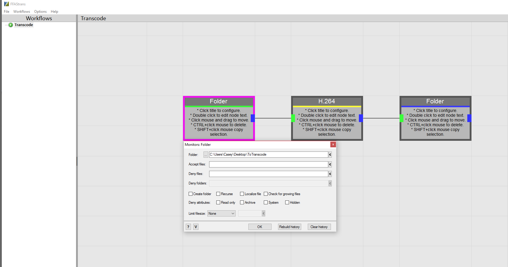

@taner Okay, how do I do that? This is probably basic stuff, but I can't seem to find any documentation. Sorry!

Re: Monitor folders not working?
Hi CaseyMazur, thank you for using FFAStrans and welcome to the forum!
You do not need to check the "growing files"-options. Can you please try and submit a file manually to the workflow? Also, make sure your AV don't kill any of the important FFAStrans files in the Processors folder: exe_manager.exe, def_runner.exe and processors.exe.
Oh, and just to check (and maybe a stupid question); you HAVE opened the status monitor (under Options), right?

Yes, I have opened the monitor to see if anything happens when I drop in a file. I just reset the entire program, but to no avail, it still doesn't work. When I manually submit a file, it works fine. I will create an exclusion in my AV for this folder to see if that helps.

You save the workflow by right-clicking in the editor area. You can also press CTRL+S....which is not a very unusual approach
While we're at it, you have you connected the nodes?
Basic FFAStrans usage: https://www.youtube.com/watch?v=RMISBx6iSeQ&t=149s
I just want to make sure you know the basics of creating a workflow before further investigation.
