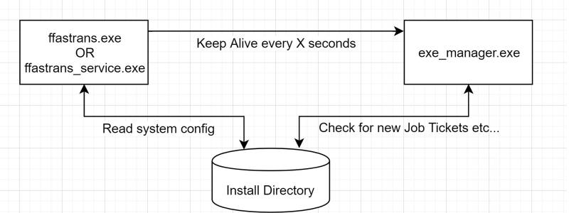

ffastrans.exe
ffastrans.exe can fulfill multiple purposes, depending on if ffastrans is installed as windows service:

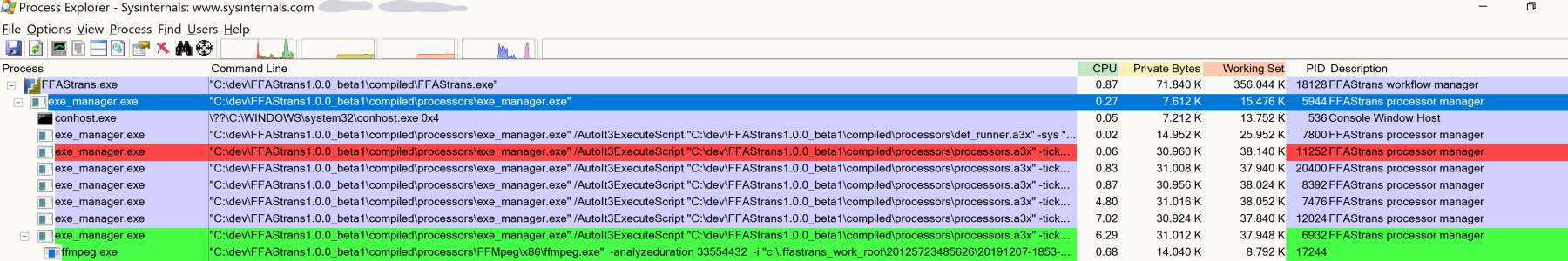

- when rest_service is NOT installed, it fulfills the job of rest_service
In this picture, we see ffastrans.exe on a standalone host, not installed as service. ffastrans.exe took care about starting exe_manager which again started different sub-processes, e.g. def_runner.a3x and processors.a3x

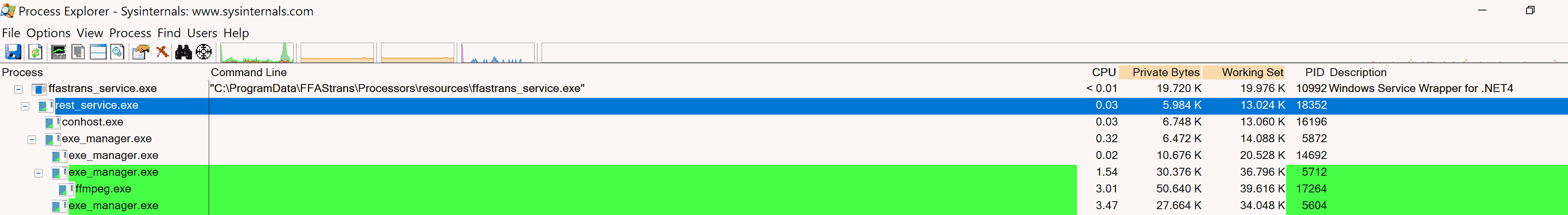

rest_service.exe
- keep exe_manager alive
- provide http API service
In this picture, we see that rest_service.exe took care about starting exe_manager.

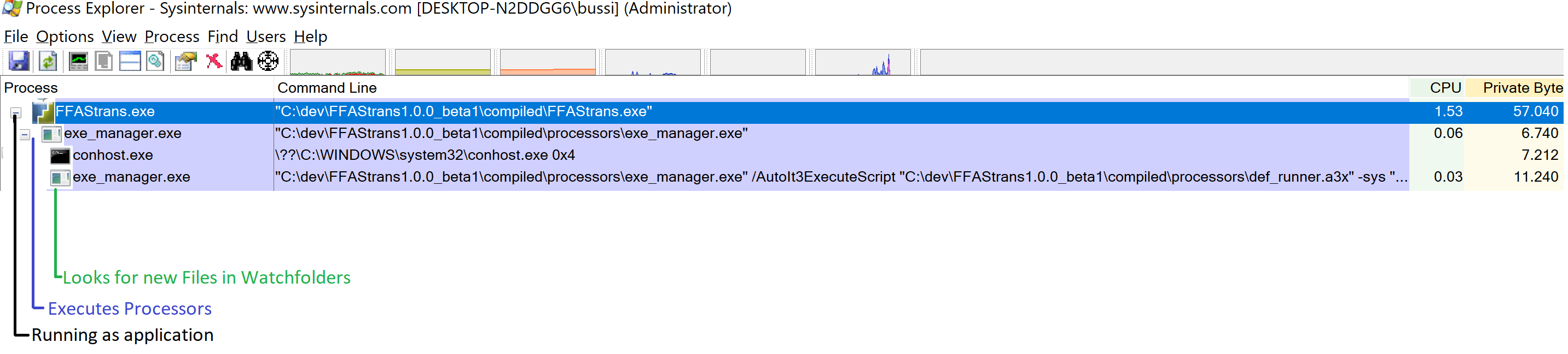

def_runner.a3x
def_runner.a3x is started by exe_manager in case there are any active workflows that need watching for new files.
In this picture, we see that exe_manager started a sub-process that is also called exe_manager but when looking at the “command line”, we see that one of the exe_manager sub-processes takes care about def_runner.a3x

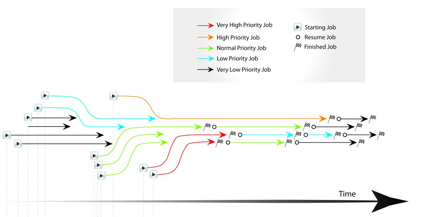

Priority flow chart and example
Since the 1.1.0.0 FFAStrans release, all the jobs are processed regarding to their priority :
FFAStrans Workflow properties\Priority → 0(Very Low)-1(Low)-2(Normal)-3(High)-4(Very High)
Each time a new higher priority branch (or job) is being put into queue, it will start before all lower priority queuedjobs *
Once a branch/job has been started, the priority does not matter anymore *
Example for 4 max active jobs on 1 host, 2 hosts with 2 max active jobs or 4 hosts with 1 max active job:

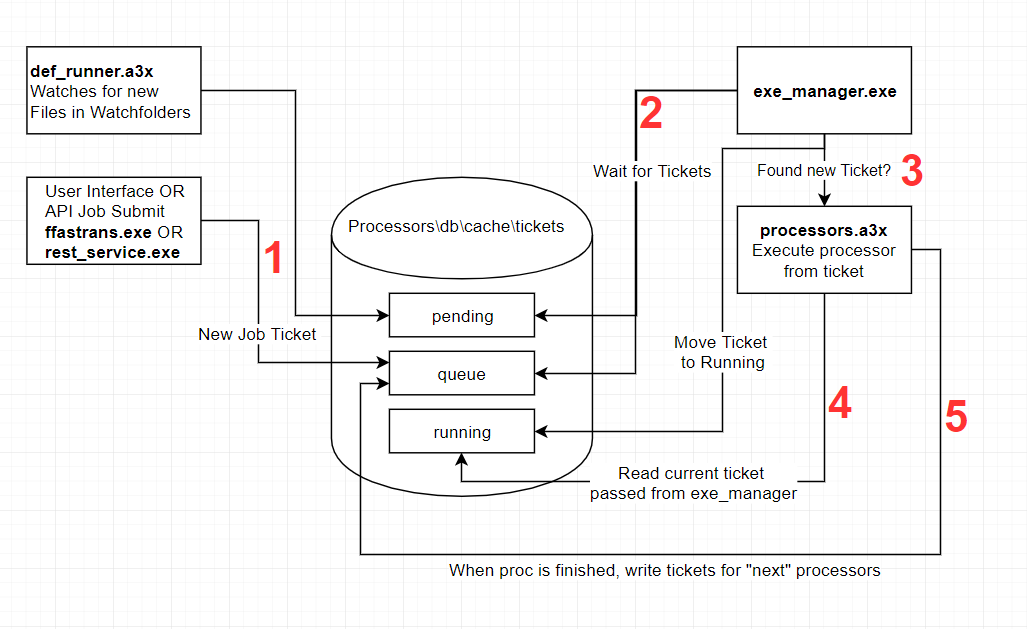

Job Ticket Management
This picture shows how the different processes work with Job Tickets.
- Various job starting methods create tickets (.json file) in either pending or queued folder
- Queued or pending tickets are being read by exe_manager
- exe_manager spawns a processors.a3x process for each ticket
- processors.a3x reads ticket, decides if the current host and CPU allows to execute the ticket and in case it executes the processor from the current ticket
- when the processor finished, processors.a3x parses from the workflow which processors are next to be executed and places the corresponding tickets into queued folder, the process starts over at 3
