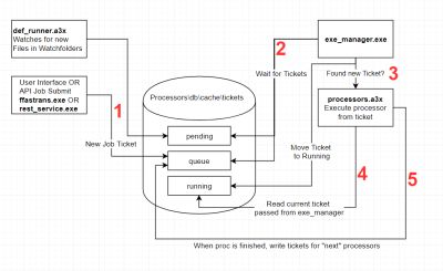

Job Ticket Management
This picture shows how the different processes work with Job Tickets.
  1. Various job starting methods create tickets (.json file) in either pending or queued folder
  2. Queued or pending tickets are being read by exe_manager
  3. exe_manager spawns a processors.a3x process for each ticket
  4. processors.a3x reads ticket, decides if the current host and CPU allows to execute the ticket and in case it executes the processor from the current ticket
  5. when the processor finished, processors.a3x parses from the workflow which processors are next to be executed and places the corresponding tickets into queued folder, the process starts over at 3
