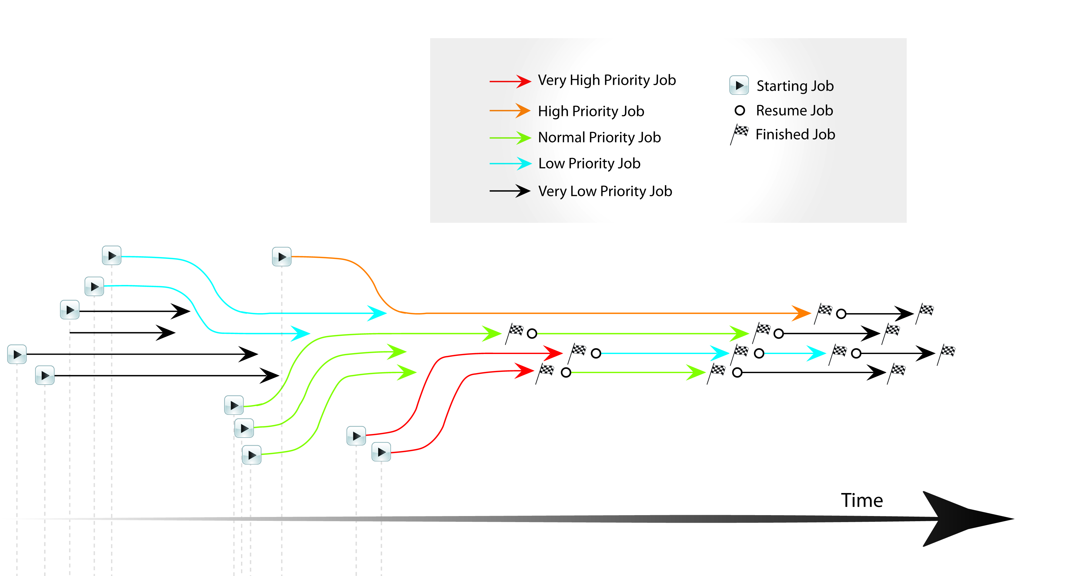

Priority flow chart and example
Since the 1.1.0.0 FFAStrans release, all the jobs are processed regarding to their priority :
FFAStrans Workflow properties\Priority → 0(Very Low)-1(Low)-2(Normal)-3(High)-4(Very High)
Each time a new higher priority job starts, it will replace a lower priority job until maximum jobs allowed is reached
Example for 4 maximum active jobs configuration or 2 hosts with 2 maximum active jobs.
