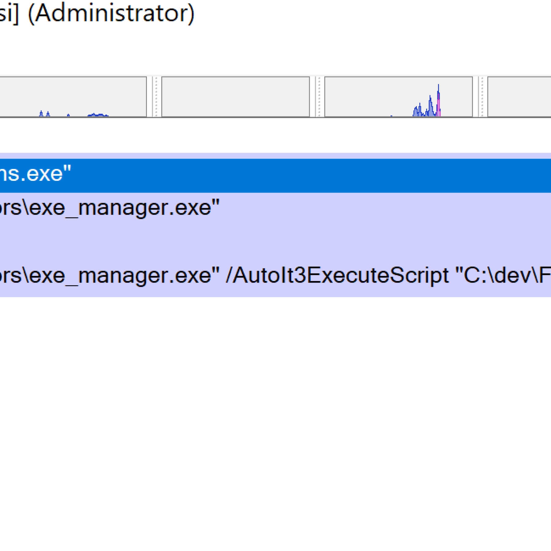

In this picture, we see ffastrans.exe on a standalone host, not installed as service. ffastrans.exe took care about starting exe_manager which again started different sub-processes, e.g. def_runner.a3x and processors.a3x

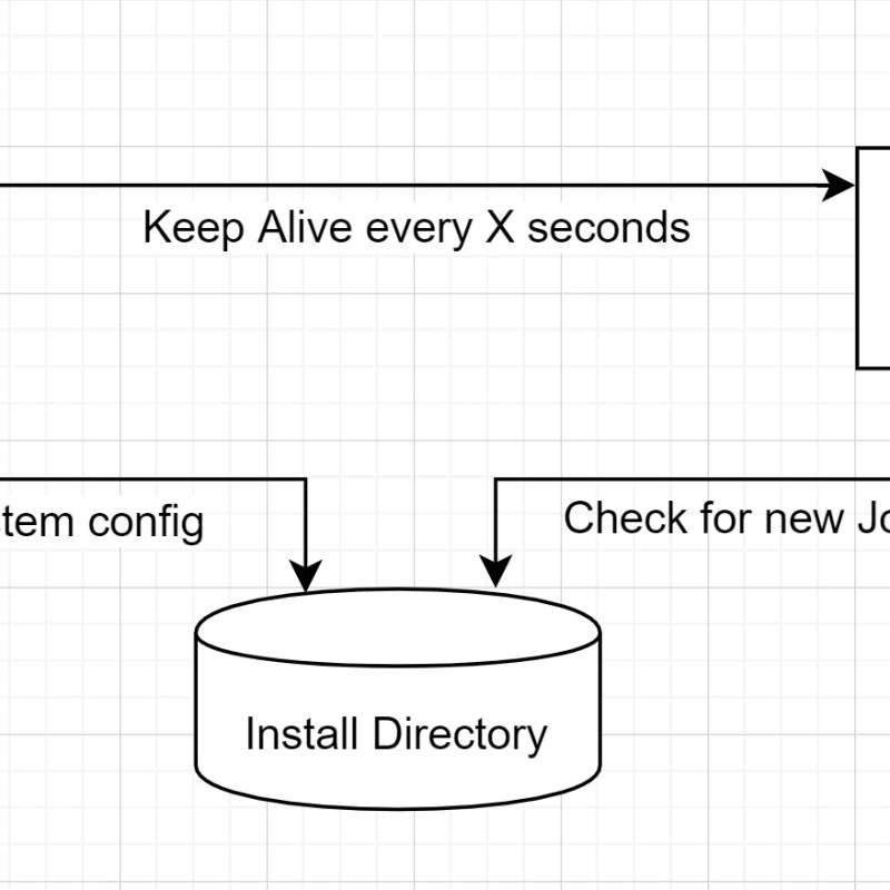

rest_service.exe
  • keep exe_manager alive
  • provide http API service
In this picture, we see that rest_service.exe took care about starting exe_manager.

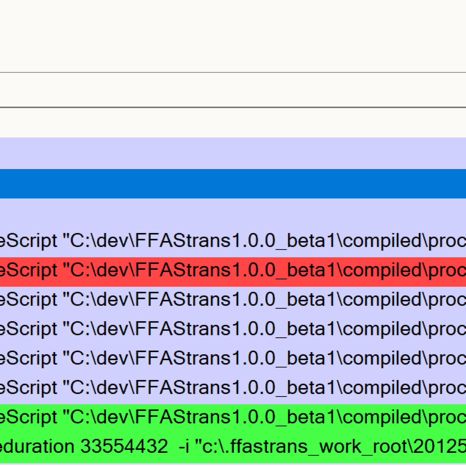

In this picture, we see that exe_manager started a sub-process that is also called exe_manager but when looking at the “command line”, we see that one of the exe_manager sub-processes takes care about def_runner.a3x

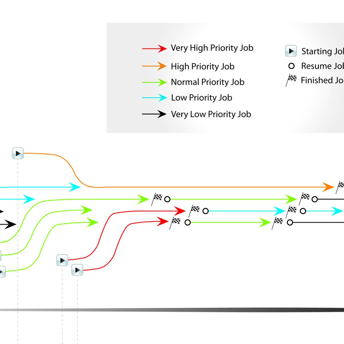

Priority flow chart and example
Since the 1.1.0.0 FFAStrans release, all the jobs are processed regarding to their priority :
FFAStrans Workflow properties\Priority → 0(Very Low)-1(Low)-2(Normal)-3(High)-4(Very High)
Each time a new higher priority branch (or job) is being put into queue, it will start before all lower priority queuedjobs * Once a branch/job has been started, the priority does not matter anymore *
Example for 4 max active jobs on 1 host, 2 hosts with 2 max active jobs or 4 hosts with 1 max active job:

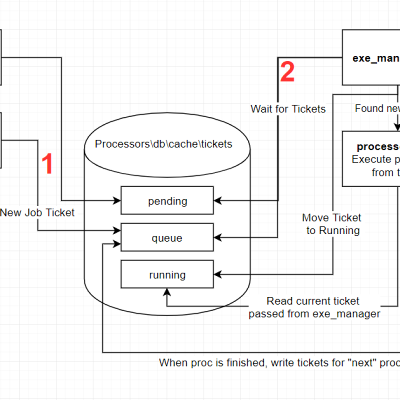

Job Ticket Management
This picture shows how the different processes work with Job Tickets.
  1. Various job starting methods create tickets (.json file) in either pending or queued folder
  2. Queued or pending tickets are being read by exe_manager
  3. exe_manager spawns a processors.a3x process for each ticket
  4. processors.a3x reads ticket, decides if the current host and CPU allows to execute the ticket and in case it executes the processor from the current ticket
  5. when the processor finished, processors.a3x parses from the workflow which processors are next to be executed and places the corresponding tickets into queued folder, the process starts over at 3
